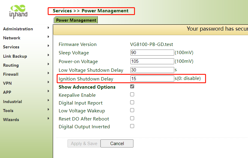

How to configure ignition off delay. That seem to be 30s by default.: In Webpage  Services >>
 Power Management  Ignition Shutdown Delay
How to disable ignition off in order to keep VG710 awake 24/7.  In Services >>  Power Management   Ignition Shutdown Delay config 0s,IGT will be disable.

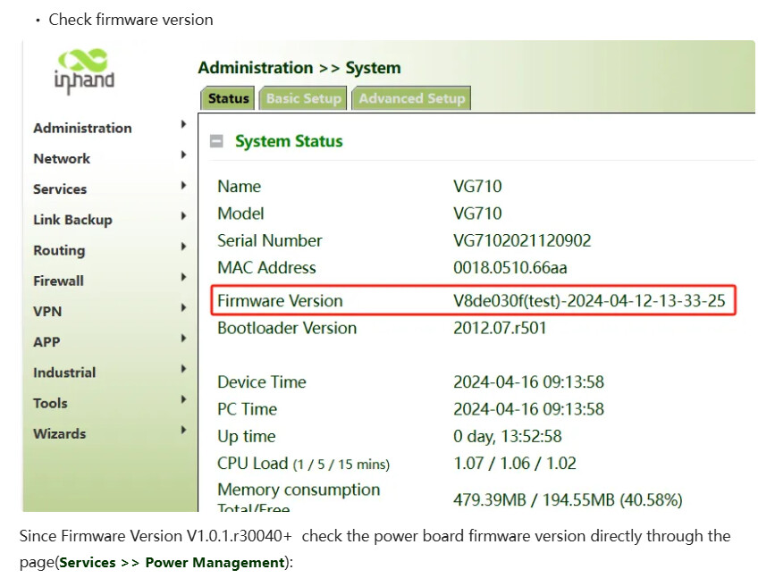

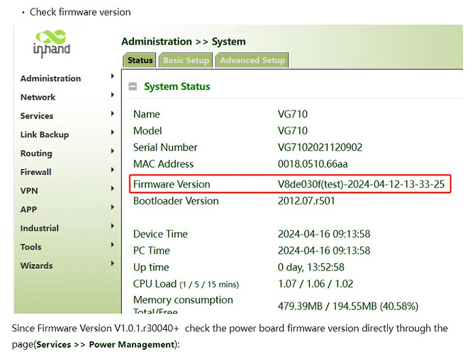

Hello, the power management page is only supported in firmware version V1.0.1.r30040+. Please check the firmware version you are currently using.
Could you please confirm if your issue has been resolved? If not, please provide the version number of the power board below so that we can investigate further. Alternatively, providing the product serial number would also be helpful.
