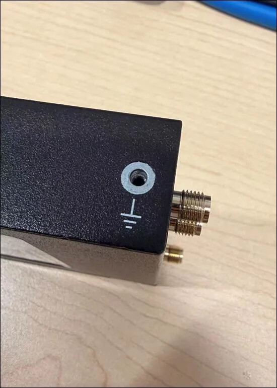

If the device chassis is not properly grounded, it may increase the risk of electrostatic discharge (ESD), which could potentially affect sensitive components such as the WiFi module. Here is the guide:
1. Remove the screw.
541×692 83.6 KB

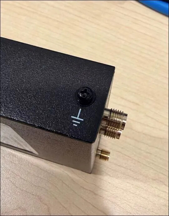

2. Connect
IR302 grounding knob to the "GROUNDED" panel.
550×770 82.2 KB

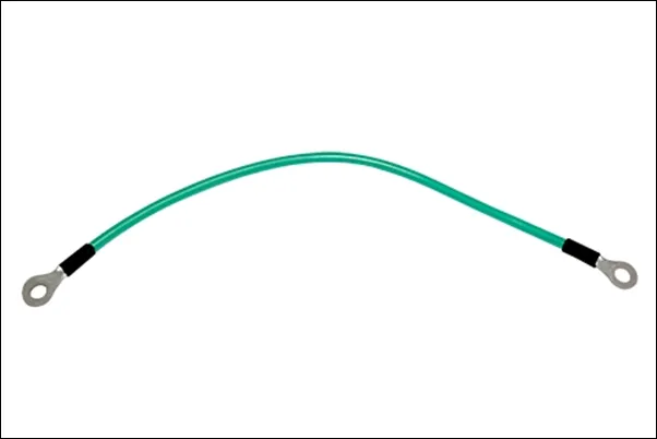

3. You may use this kind of cable for grounding.
602×402 26.6 KB
