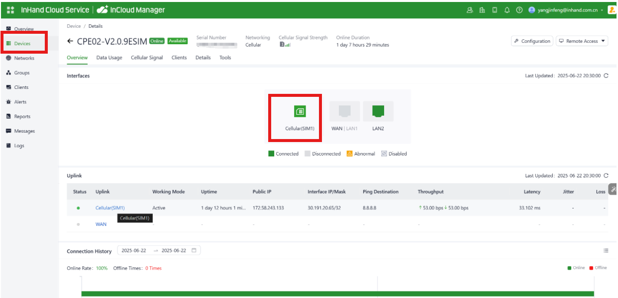

Click on [ Dashboard ] in the left menu to access the dashboard interface.

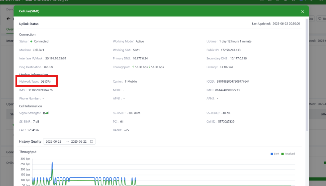

Click the interface name under [Uplink] to view the interface details.
